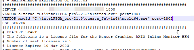

How to get the license file to allow Questa 21.3 and Questa 22.2 to work at the same time
We got our 21.3 version to work by adding in the VENDOR mgcld "C:\intelFPGA_pro\21.3\questa_fe\win64\mgcld64.exe" port=1802 to the license.dat file. But we can't figure out how to get the 22.2 version to ALSO work.

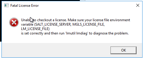

When we try to launch Questa 22.2 we get this error. We have added in all the variables but it's still not working.

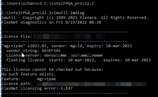

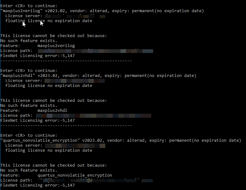

We ran the lmutil lmdiag and saw weird things like this come up in the results. Saying no such feature exists. Not sure if this is the issue..... or we are just missing something from our license.dat file.
