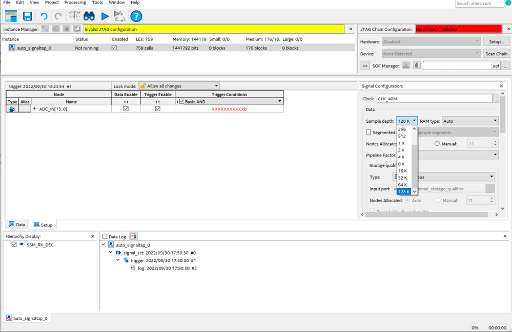

Sampling Clock : 40Mhz
Required period : 5ms or over
i tried ram size maximum 128k @ 3ms under
so is there any way how to capture data over 1ms

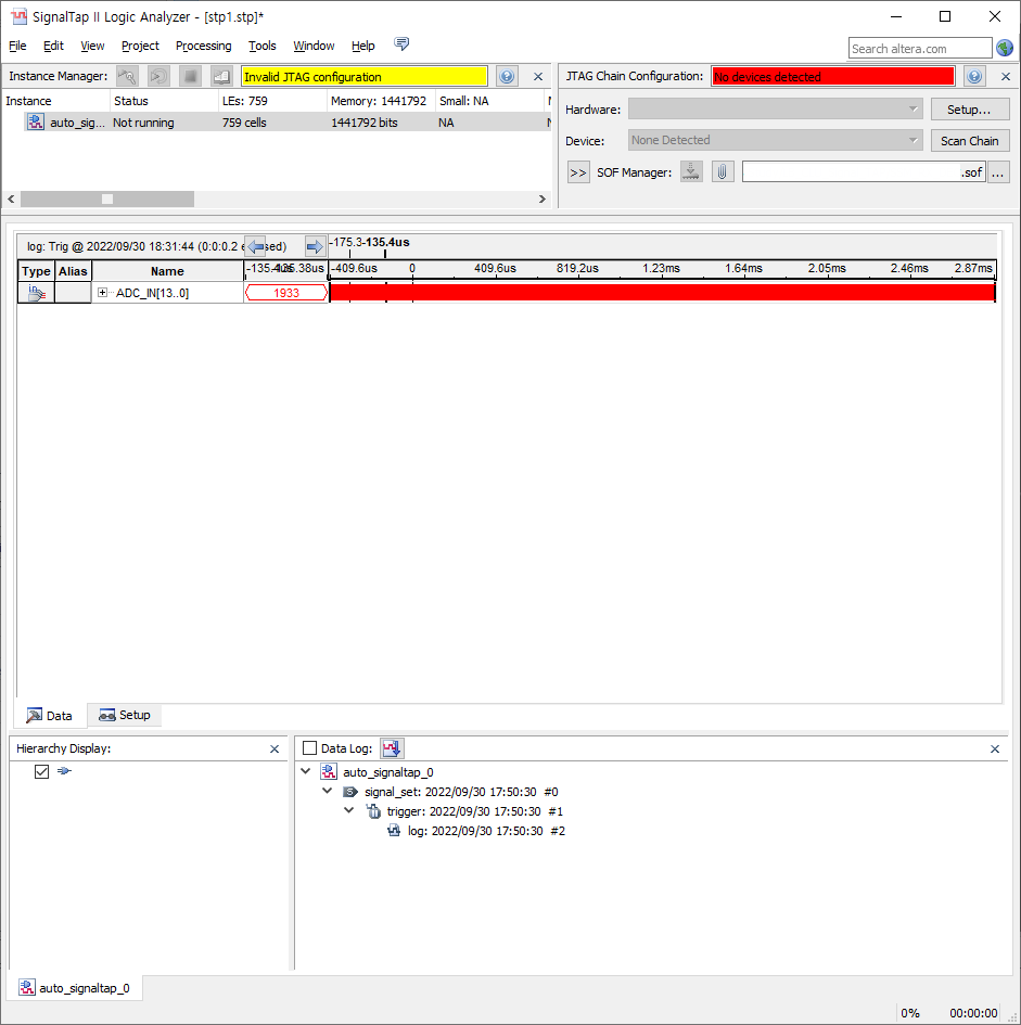

i wanna Capture Data for 10ms (@ posedge 40Mhz Clock)
but Signal Tap Sample depth maximum Setting is 128K.
at that time data length ≒ 2.87ms (≒ 3.28ms).
i wanna capture more long... is there any way capture depth more longer?
- sstrell
No. To capture more data in the existing buffer, use data qualification to store only the relevant samples. For example, if signals don't transition for a number of clock cycles, there's no need to keep all of those data samples. Use data qualification as essentially a write enable to the buffer.
