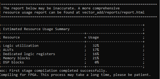

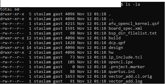

I am not stuck there any more, but i have another question, I am not able to see report.html . This is what i am able to see but no report directory has been generated.
In image below , you can see no report directory is visible. I don't know why it's not generated?
I am invoking this command:
aoc -v device/vector_add.cl -report -o bin/vector_add.aocx=pac_a10
NOTE:: I am accessing it via ssh on my local PC.
Thanks!
