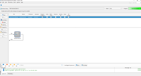

7 years agohow can i read FPGA version from Altera/Flash using Quartus programmer
quartus prime Version 19.2.0 Build 06/24/2019 SJ Pro edition
OHafu1
7 years agoHi,
im talking of reading the .jic or .sof image file that burned to the FPGA using quartos ,
is it possible to read them back?
how can i read the .pof file from Quartos?
- AnandRaj_S_Intel7 years ago
Use "examine" checkbox of the Quartus programmer to read file from flash and save the file.
