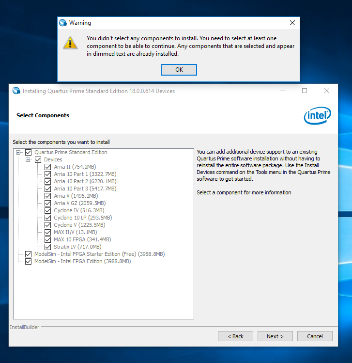

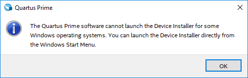

    Launch the Device installer for Quartus 13.0.1.232 from Windows start menu & browse the appropriate folder for the devices to be installed Instead of quartus tool. If you tried from quartus tool you could have seen the below attached message.
    it says Cyclon II/III/IV family devices are already installed.
    If it is already installed then that devices will grade out like below,
    check it & provide screen shot of it.
