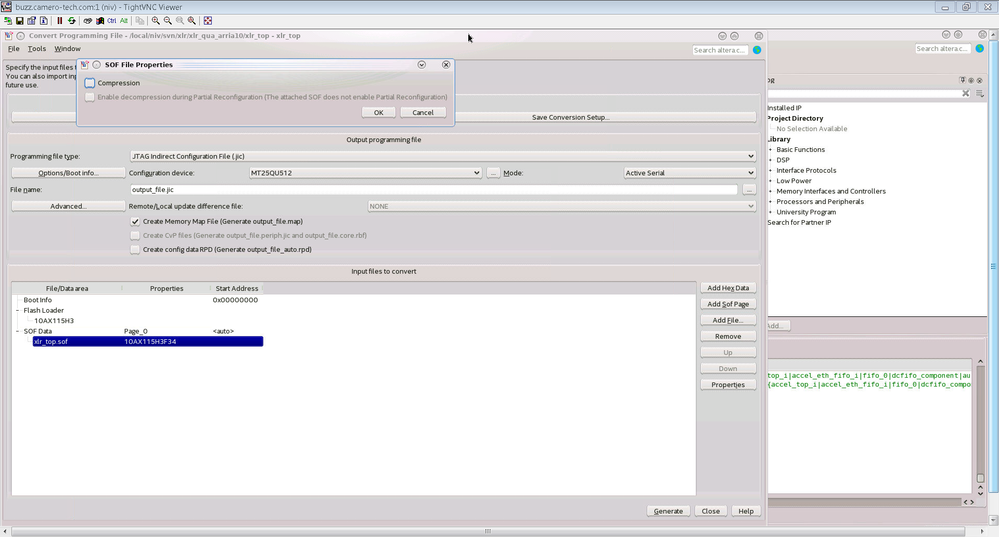

I compile my design with quartus 19.1 for arria 10 GX device and get a sof file.
then I want to generate encryption JIC file. I follow altera instruction but when I add the sof file and press the properties I have only SOF Files Properties nd not SOF Files Properties: Bitstream Encryption dialog box (can only choose the compression option).

      Hi, yes I tried to do the steps according to this document but when I reached step j (I think) press the properties of the sof file I add only compression option and not the compression and encryption option and then I stuck. I tried to understand why I don't have the encryption option. Thanks Niv.

    Per your response, you are following the correct steps. I have tested, and i got SOF Files Properties: Bitstream Encryption . Can you attach the screenshot of the SOF Files Properties? And what is Quartus 19.1 that you use( Lite, Standard, PRO)?

      I used quartus 19.1 standard edition
      I attach picture of what I got from the sof properties
      could it be that I miss something in the quartus installation?

    1. No. You cannot generate ekp file while using temporary license. Are you using temporary license? Hence I assume that's the reason why you encountered this issue.
