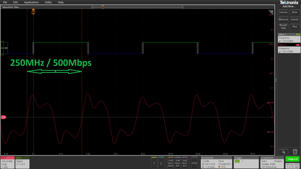

To clarify: this error persists, independent of the toggle rate of the pin, as it is an issue with the quartus software deriving the real toggle rate and has nothing to do with the datasheet specification. To highlight this i have modified the example to a division factor of 4, now delivering instead of 500Mhz (=1Gbps) as before an output rate of 250MHz (=500Mbps) which is well within the datasheet specification. You can modify this to any arbitrary division factor, the issue will persist no matter how low you make the toggle rate of the pin:

Thanks @chris_notsch for clarifying the issue. The problem statement is: PLL output clock 1Ghz is divided down by internal logics to 500Mhz at the output pin (set as LVDS IO Standard). Despite not toggling at 1Ghz, why did it complain that it is (thus causing an error of exceeding the maximum rate)?
