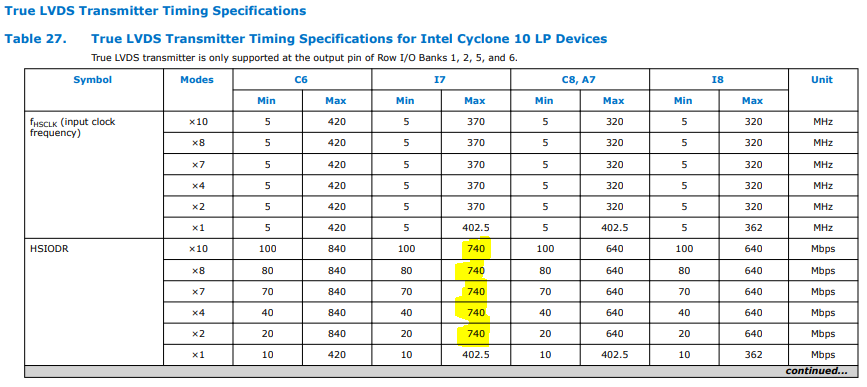

Thanks for the design. I have a better idea now. You are trying to make a GPIO IO standard LVDS to toggle at 1GHz. It will message: Error (176060): The transmitter driving I/O pin pin_arduinobus_j7_4 at data rate 1000 Mbps exceeds the maximum allowed data rate of 740 Mbps for LVDS output
This is expected as the datasheet stated:
- chris_notsch6 years ago
