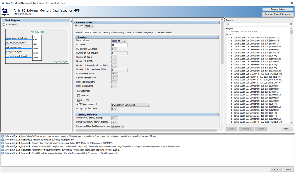

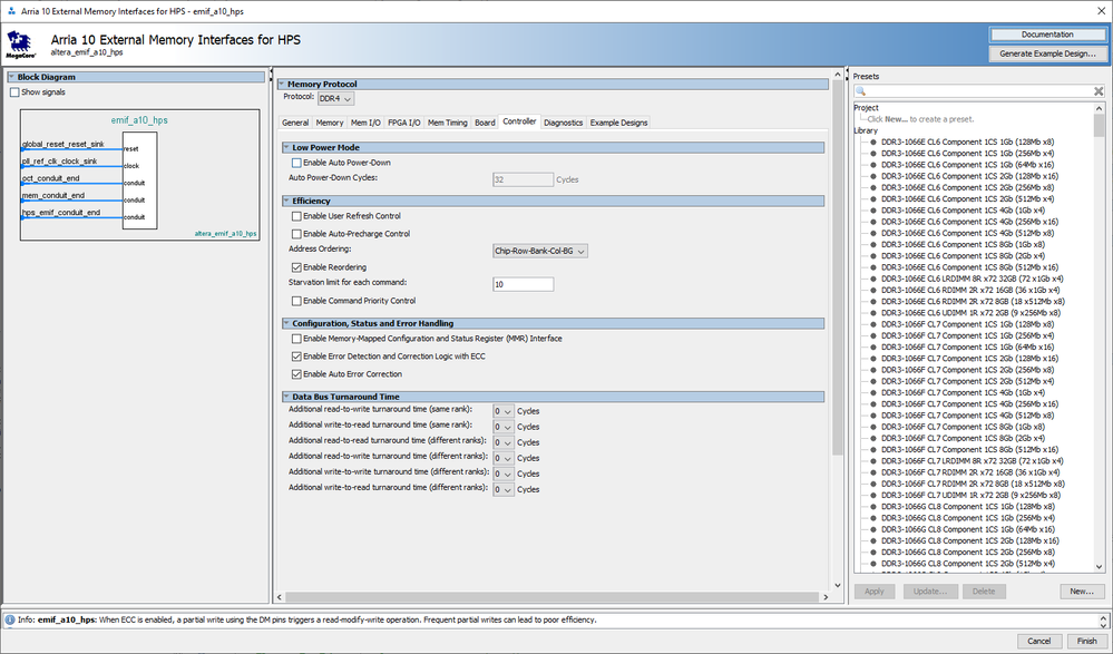

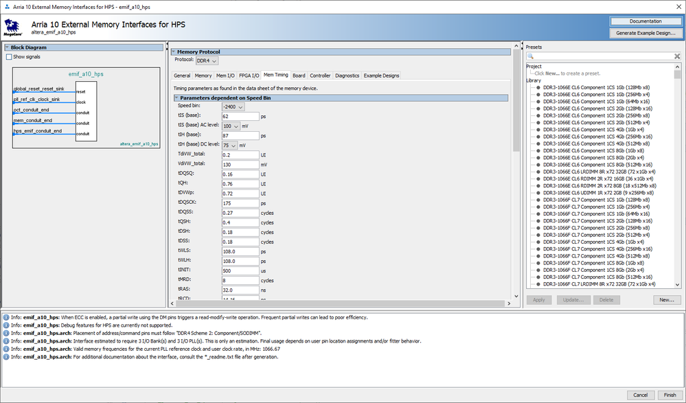

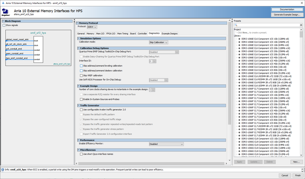

Screenshot of the EMIF IP configuration is attached here for reference.
