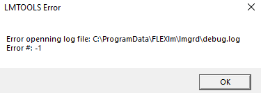

I have the config services tab settings in based on what I can tell from the video, and am now stuck on when I run it the log file gives me an error saying:
LMTools Error
Error opening log file: C\ProgramData\FLEXlm\lmgrd\debug.log
Error #:-1From what I can find I have to change the permissions on the log file location to something that I am in control of. I changed the permissions from Administrators to domain admins, and I have tried testing lmtools running in admin mode however it still generates the same error.

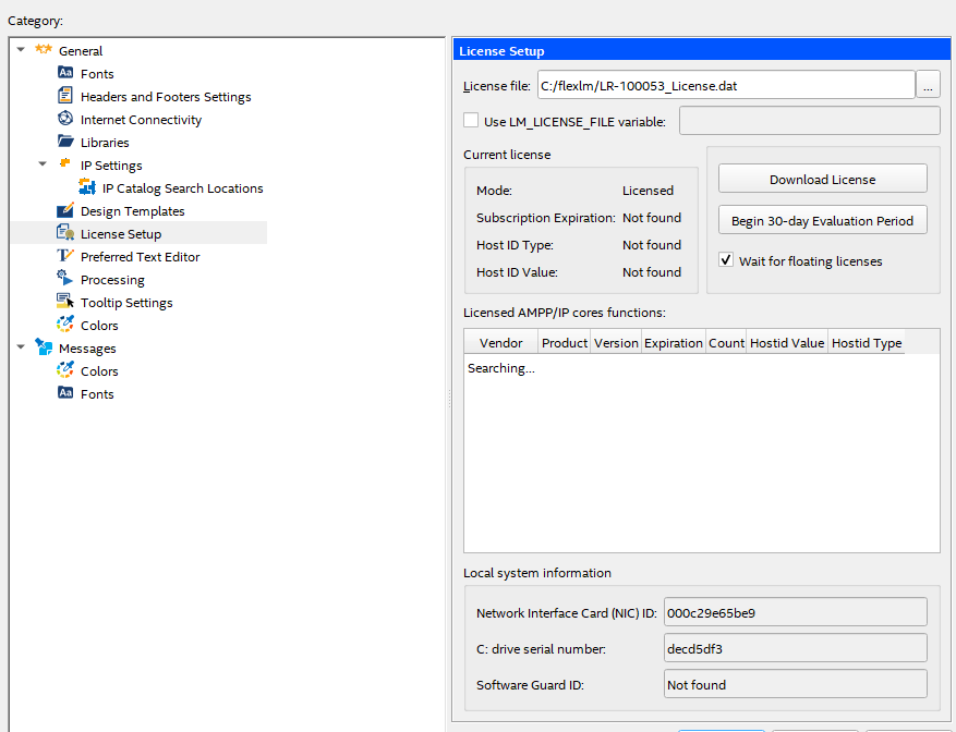

2) Screenshot of Quartus II>>tools>>license setup
Im not sure I am using Quartus II, I have as far as I know only downloaded Intel® Quartus® Prime Pro Edition Software (Device support not included), to run the license server portion on my server, Should I be using Quartus II?

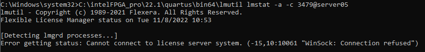

5) Output of “lmutil lmstat –a –c <port>@<address>” server and client
This most likely is not working because the services arent setup properly and I keep getting the earlier error. However, this is what I got back from running these commands.

If all has gone well, a user with an installed version of quartus should be able to go in to the license setup tab or open quartus and tell it you have a license file.
in the top line enter, example, 1777@servername, then select the box that says "wait for floating license" if things have gone well, your licenses should appear in the large box and youre all set.
