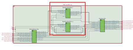

Please see the technology Map viewer as well. It seems there is no issue with the IP or build or resource estimation.

I looked at the technology Map viewer everything seems to be implemented correctly. I now managed to have more DSP blocks used when building the project. Do you mean with "scaling" whether to truncate or saturate the output ?
I still have an issue I have nothing at the output when I test the implementation. Is it possible to simulate only certain blocks (like the fir filter) in my whole project instead of the whole project?
I am adapting the BladeRF project which has a lot of blocks but I only want to simulate the blocks I added to that project and implemented myself. Also I have Quartus Prime Lite Edition. Can I simulate with it for free or do i need a license for simulations ?
