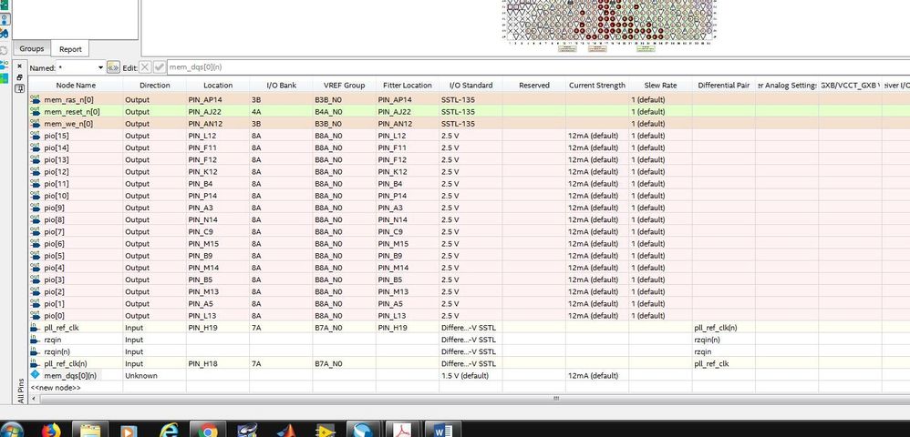

7 years agofew nodes ( I/O pins) are automatically added while pin assignment, that are not relevant to my design. what to do with as I am not able to remove them?
I don't know what to do with these extra pins and I have tried to delete them but it says "CAN'T DELETE BUS BIT". Those are some sort of replica of the pin in design, even though their I/O Standard is not set to differential . it can be seen at last in image above.
1 Reply
- Vicky1
Can you please check with quartus setting file *.qsf?
It can overwrite the previous assignments.
Please refer the "7.2.1.4.1. Adding Pins and DQ Group Assignments" from the link below,
https://www.intel.com/content/dam/www/programmable/us/en/pdfs/literature/hb/external-memory/emi_plan.pdf
Vicky
