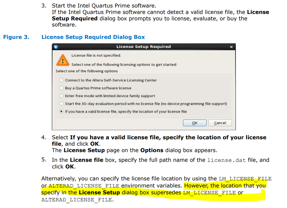

      The way I used to pass lecense server location to quartus during tests was through LM_LICENSE_FILE env variable. During using our automated testings Quartus could'nt find license. We identified the problem as quartus prefering dialog-box input upon using LM_LICENSE_FILE as specified in the link you gave me, and in some other documents:
      We temporarily solved this problem by opening GUI, and through GUI manually chose to use LM_LICENSE_FILE instead of the dialog-box. Quartus keeps this settings, so we now can run our tests wihtout problems (as quartus now prefers the use of LM_LICENSE_FILE). But if the settings will somehow change / reset to default the issue will rise again.
      Therefore, I'm searching for a tcl script/bash/terminal command that setups the license file/server without using GUI, or alternatively a command that tells Quartus to prefer search for license through LM_LICENSE_FILE instead of the dialog-box input, again, without using GUI.
