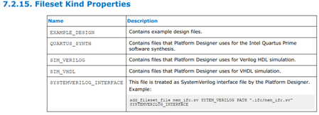

add_sv_interface and add_fileset_file <file_name>.sv SYSTEM_VERILOG PATH ../<file_name>.sv SYSTEMVERILOG_INTERFACE are attributes supported by pro version only check screenshot.
Standard version don't support those attributes check screenshot. Please use other attributes instead. Probably there're some problem with the document, I'll report this to related document team.
