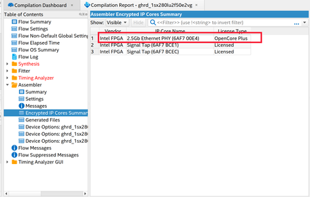

3 years agoFailed to create JIC file from stratix 10 latest GSRD
AFAIK, the default ghrd_1sx280lu2f50e2vg_hps.sof file does not come with an external JTAG connection, correct? To enable the external JTAG connection via the Mictor 38 JTAG connector on the HPS dau...

I have tried compiling the latest Stratix10 GHRD and did not met the error that you are looking at and compilation was successful with Quartus 23.1Pro.
I am following the steps here:
https://www.rocketboards.org/foswiki/Documentation/Stratix10SoCGSRD#Building_the_Hardware_Design
Could you point me the location in which you get the latest Stratix10 GHRD?
