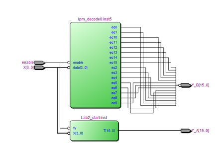

When i open file "Lab2_full.qpf" and go to "Files" in Project navigator i see 3 files : "Lab2_start.bdf", "Lab2_full.bdf", "lpm_decode0.bdf",
and when i set as top-level for "Lab2_full.bdf", TRL-viewer work correctly ( i can double click in RTL-viewer on "lab2_start.inst"(1st photo upper ) ) but if i set as Top-level for "Lab2_start", in RTL-viewer i can see only "Lab2_start"-RTL.
IDK why, but when i set TOP-level for "Lab2_start", compilator like don't see another files(i tried delete in "Lab2_full" all bus, and 0 errors with that)
And i can create by double click on empty space my bsf schematic of "Lab2_start"
I hope u understand my explain :3

And after when i recreate project, from 0, i copied file from 1 project where i have main scheme, to folder with comparison scheme ( where LPM_decode and Lab2_start ) when i set Top-level to 2nd file i still have this problem
