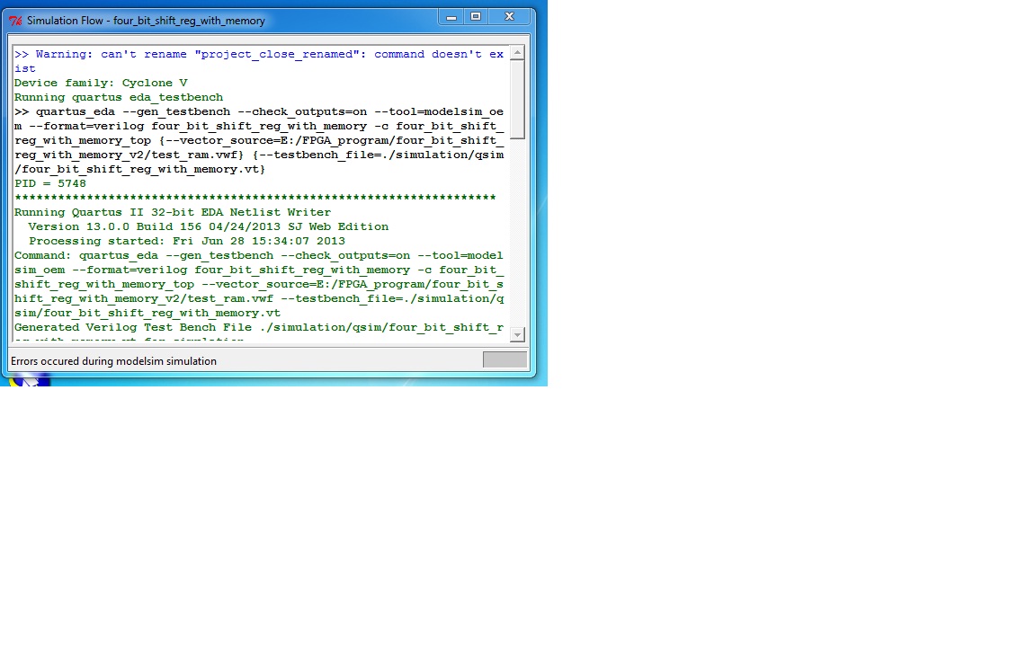

Error msg when running the modelsim simulation on Quartus II
Hi all
Do you know how to solve this error?
refer attach
error:
>> Warning: can't rename "project_close_renamed": command doesn't exist
Device family: Cyclone V
Running quartus eda_testbench
>> quartus_eda --gen_testbench --check_outputs=on --tool=modelsim_oem --format=verilog four_bit_shift_reg_with_memory -c four_bit_shift_reg_with_memory_top {--vector_source=E:/FPGA_program/four_bit_shift_reg_with_memory_v2/test_ram.vwf} {--testbench_file=./simulation/qsim/four_bit_shift_reg_with_memory.vt}
PID = 5748
Running Quartus II 32-bit EDA Netlist Writer
Version 13.0.0 Build 156 04/24/2013 SJ Web Edition
Processing started: Fri Jun 28 15:34:07 2013
Command: quartus_eda --gen_testbench --check_outputs=on --tool=modelsim_oem --format=verilog four_bit_shift_reg_with_memory -c four_bit_shift_reg_with_memory_top --vector_source=E:/FPGA_program/four_bit_shift_reg_with_memory_v2/test_ram.vwf --testbench_file=./simulation/qsim/four_bit_shift_reg_with_memory.vt
Generated Verilog Test Bench File ./simulation/qsim/four_bit_shift_reg_with_memory.vt for simulation
Quartus II 32-bit EDA Netlist Writer was successful. 0 errors, 0 warnings
Peak virtual memory: 354 megabytes
Processing ended: Fri Jun 28 15:34:09 2013
Elapsed time: 00:00:02
Total CPU time (on all processors): 00:00:02
Running quartus eda_func_netlist
>> quartus_eda --functional=on --simulation --tool=modelsim_oem --format=verilog four_bit_shift_reg_with_memory -c four_bit_shift_reg_with_memory_top
PID = 2248
Processing started: Fri Jun 28 15:34:09 2013
Command: quartus_eda --functional=on --simulation=on --tool=modelsim_oem --format=verilog four_bit_shift_reg_with_memory -c four_bit_shift_reg_with_memory_top
Generated file four_bit_shift_reg_with_memory_top.vo in folder "E:/FPGA_program/four_bit_shift_reg_with_memory_v2/simulation/modelsim/" for EDA simulation tool
Peak virtual memory: 357 megabytes
Processing ended: Fri Jun 28 15:34:11 2013
Running quartus modelsim
>> vsim -c -do four_bit_shift_reg_with_memory.do
PID = 3124
Reading C:/altera/13.0/modelsim_ase/tcl/vsim/pref.tcl
# 10.1d
# do four_bit_shift_reg_with_memory.do
# ** Warning: (vlib-34) Library already exists at "work".
# Model Technology ModelSim ALTERA vlog 10.1d Compiler 2012.11 Nov 2 2012
# ** Error: (vlog-7) Failed to open design unit file "four_bit_shift_reg_with_memory_top.vo" in read mode.
# No such file or directory. (errno = ENOENT)
# ** Error: c:/altera/13.0/modelsim_ase/win32aloem/vlog failed.
# Executing ONERROR command at macro ./four_bit_shift_reg_with_memory.do line 3
