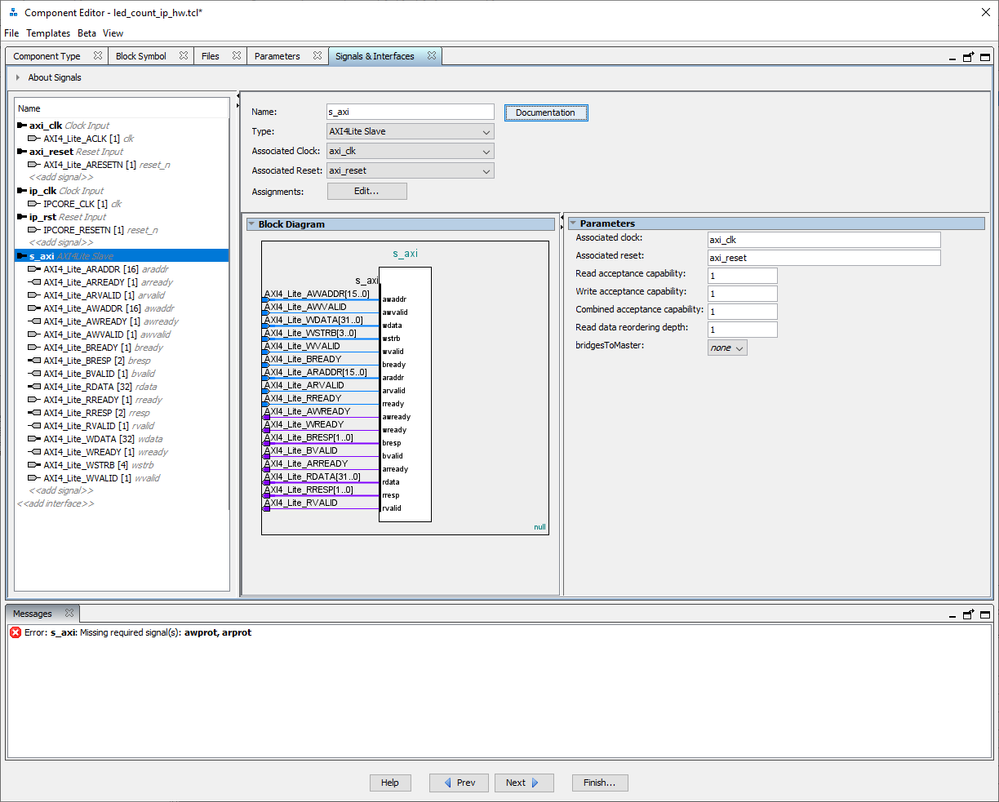

I am using Intel Quartus Standard 21.1.
I created a new component with Type as AXI4Lite Slave as shown in the below screenshot.
I am getting this error: Missing required signal(s): awprot, arprot.

According to the spec (https://developer.arm.com/documentation/ihi0022/e/AMBA-AXI4-Lite-Interface-Specification/AMBA-AXI4-Lite/Definition-of-AXI4-Lite/Signal-list?lang=en), those signals are required. Did you use a template here or add the signals manually? If 22.4 is not showing an error, either the bug is there or the interconnect in the newer version of the tool can automatically handle the missing signals.
- ShengN_altera
Previously, there's similar problem in pro version and had been fixed. The awprot, arprot signals are claimed to be optional signals. I had reported the bug in standard version to internal engineering team.
