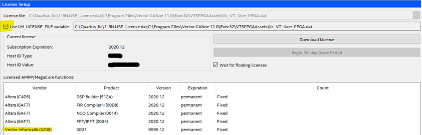

  • To complete my solution, here is a screenshot of the tick that has to be set in the License Setup, so that the link with Vector's third-party software works:
    The cause of the error message from the original question is, the feature line for Vector is not included in the Intel license file, but in a seperate one, that has to be included.

      Hi @AR_A_Intel,
      I have finally been able to fix the error!
      While searching for your requested information, I came across the License Setup, where the check mark for the mentioned VT_User_FPGA variable was not set.
      After the tick was set, the Vector licence also appeared in the list below.
      Compiling now works again!
      Thanks for your help!
      • MFoe's avatar
        MFoe
