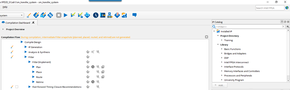

        sstrell
        Are you saying that you cannot make the IP Catalog appear in Quartus (within the tool itself; not necessarily popped out)? By default it appears in the upper right-hand corner of the tool. Or are you still referring to seeing the IP Parameter Editor vs. the old Megawizard?
