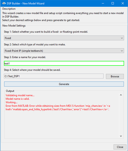

I use MATLAB R2022b with Quartus Prime Standard 19.1 and DSP Builder 19.1. But it does not work as expected. Here is what I do.
Open “DSP Builder – Start in MATLAB R2022b_x64”
Open Sim...

MATLAB R2022b is not supported with Q19.1. Please refer to the below link.
https://www.intel.com/content/www/us/en/docs/programmable/683322/22-4/system-requirements.html
Please try with the compatible and supported version of Quartus with MATLAB.
Thank you
