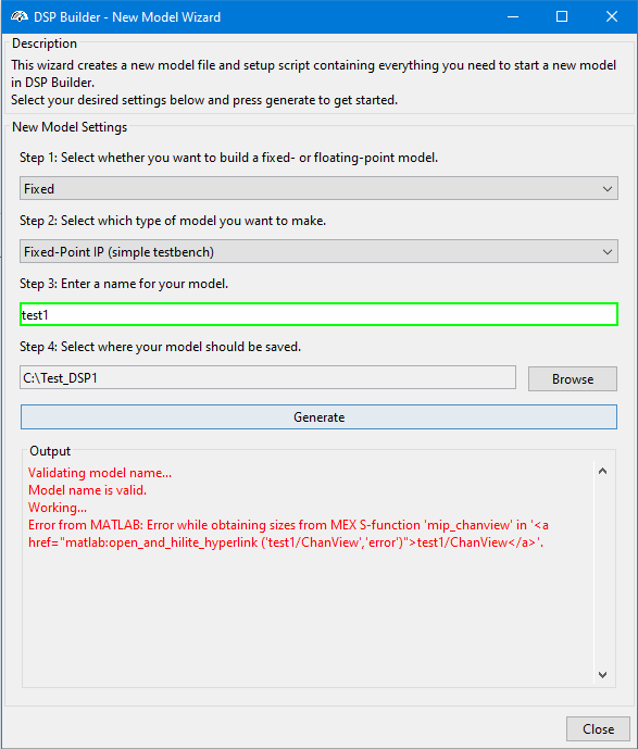

Error while obtaining sizes from MEX S-function 'mip_chanview' in 'test1/ChanView'.
DSP Builder – New Model Wizard – Output shows (see figure below, in red font)
Error from MATLAB: Error while obtaining sizes from MEX S-function 'mip_chanview' in '<a ref="matlab:open_and_hilite_hyperlink ('test1/ChanView','error')">test1/ChanView</a>'.
Sometimes it shows instead
Error from MATLAB: Error while obtaining sizes from MEX S-function 'mip_control' in '<a href="matlab:open_and_hilite_hyperlink ('test1/Control','error')">test1/Control</a>'.

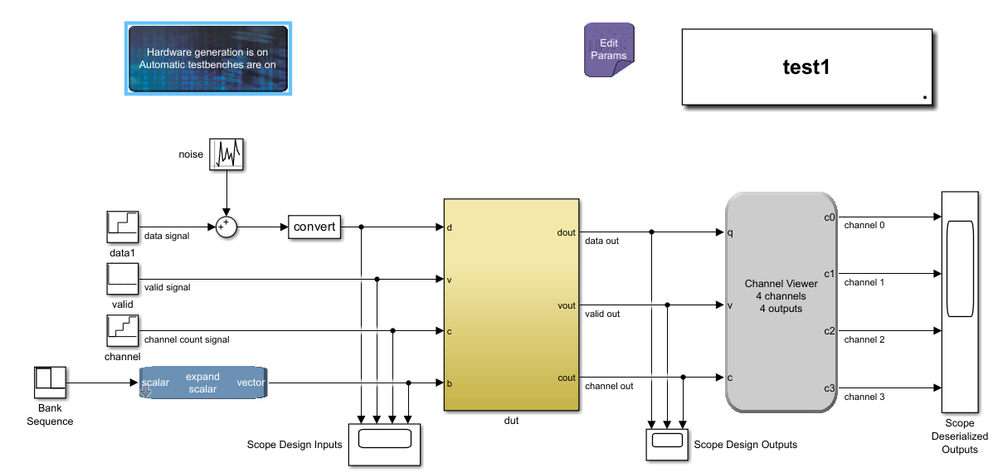

Open test1.mdl
Click on “Hardware generation is on / Automatic testbenches are on” to open the "DSP Builder for Intel FPGAs Blockset – Settings"
Click OK (with or without changing the settings)
