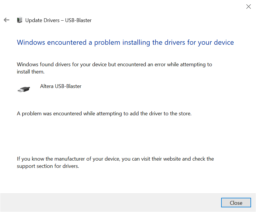

I downloaded Driver USB Blaster and tried to install it.
I got this:It says there was a problem, but does not say what it is.

You don't mention what version of Quartus you're having an issue with, but you should try the patch in the first link I posted above or try this one: https://www.intel.com/content/www/us/en/support/programmable/articles/000092460.html
