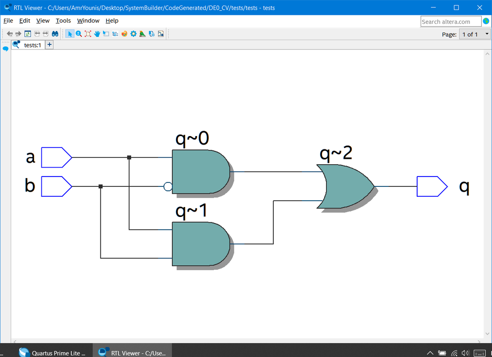

i cannot agree:
module infer (
output wire q,
input wire a, b
assign q = (a & ~b) | (a & b);
endmodule
q in this equation should = a, but here is the net schematic:

- ak6dn
Looks like you are using the 'RTL Viewer'. It displays your SOURCE RTL as a schematic. So it is displaying exactly what you entered, as expected.
If you want to see the effects of logic synthesis/optimization, open the POST MAPPING or POST FITTING views from that same menu.
- AYoun22
it looks like this is the way. yes those views provide the optimized / final views.

- sstrell
"POST MAPPING or POST FITTING views from that same menu."
Referring to the Technology Map Viewer here instead of the RTL Viewer.
