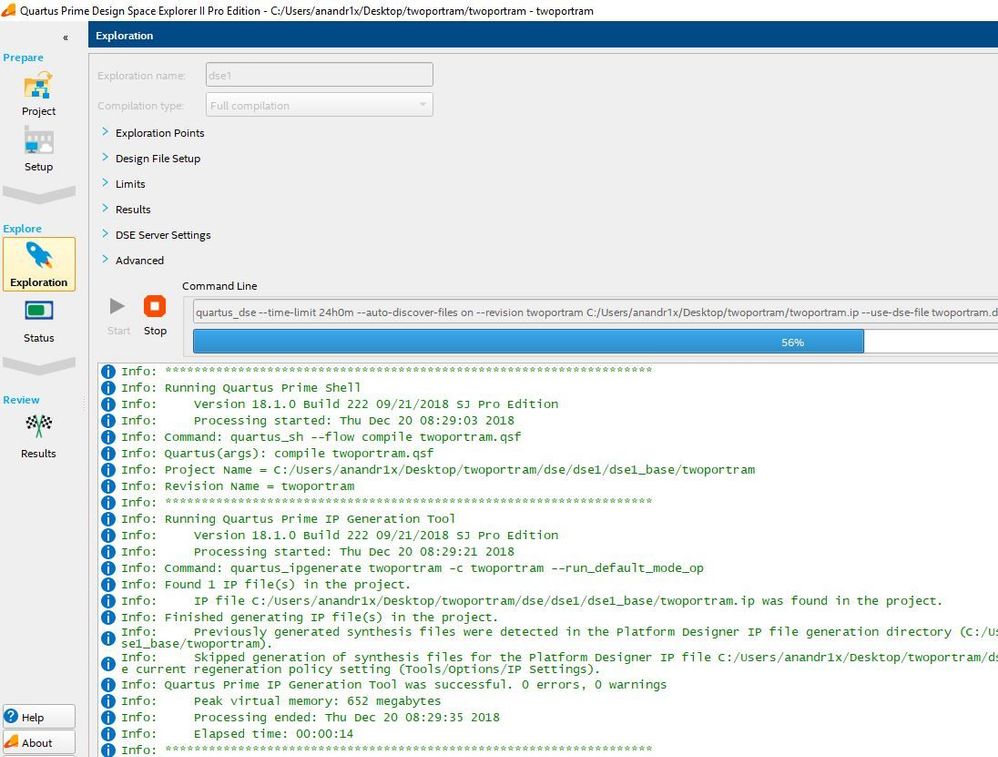

- AnandRaj_S_Intel
- Which Version & Edition of Quartus tool are you using?
- Can elaborate on the steps?
We have checked with Quartus 18.1 pro by opening project (.ip) and Started exploring the design with DSE II, by clicking on the Start which works fine.
If you are using old version of quartus try it by using latest version.
