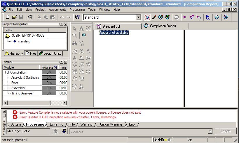

I did receive the license file, thanks. I have an installation of the full/standard version 5.0 of the design tools from my original CDs, but the project will not compile. QuartusII gives the error "Feature Compiler not available with your current license".
I thought my license allowed me to use the full verion of the NIOSII 5.0 IP core, and the full version of the QuartusII 5.0 compiler. What am I missing?

The project being compiled is one of the example NIOSII projects, one I have compiled before. I get the same errors with non-NIOSII examples (fir filter, etc.)
The compile output. There is no report generated.

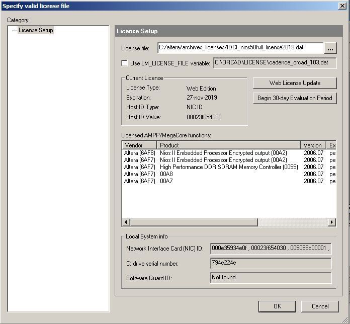

The license you sent me (renamed). Notice that it says "License Type: Web Edition" with expiration date as of yesterday.
I was hoping the regenerated license would work with the Full Version of QII since it would save me from having to install the web version. Am I wrong?
I tried the "Web License Update" button, but the Altera license servers were probably shut down long ago. It didn't work.

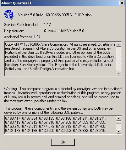

The Quartus II version

Based on my understanding, this is not nios license problem, this is the quartus problem. The quartus_lite expired, could you help apply Quartus web license again and try it https://www.intel.com/content/www/us/en/programmable/f/download/licensing/lic-q2web.html
- TClar19
I was able to get the QuartusII web license, and combine that with the NIOSII license to create a single license file. I am still using the full version of QII5.0, and this new combined license file works to compile NIOSII projects without any time limited or tethered restrictions.
