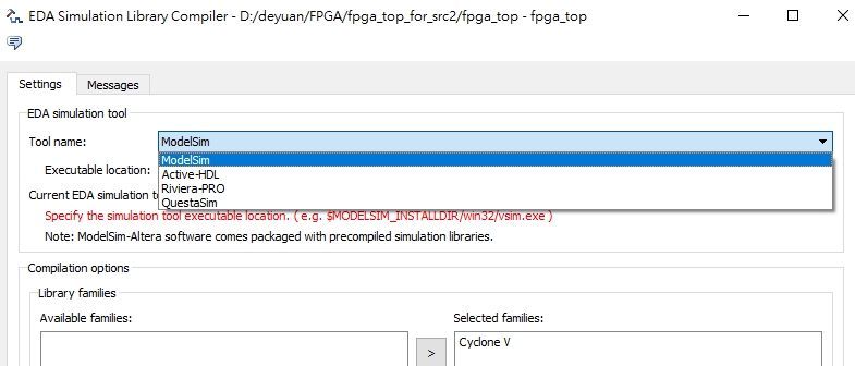

In quartus -> tools -> launch simulation compiler can't find VCS.

Are you using windows? Vcs only support in Linux. https://www.intel.com/content/dam/www/programmable/us/en/pdfs/literature/ug/ug-qpp-tp-simulation.pdf

So I need to install quartus linux version then launch simulation compiler to generate the library for your VCS,right?
- KennyT_altera
If you were using windows, you will need to switch to Linux version and install the quartus Linux version. Quartus Linux version would not be supported in windows platform. Thanks
