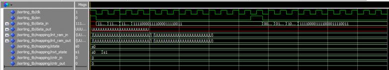

counter not incrementing for RAM with built-in counter
I am really sorry for not posting original question as whenever I try to add tags the tab refreshes and all the typed data is encrypted.
Kindly help me as its quite simple problem but somehow I dont understand why I am I having it.
The link to original problem is:
https://stackoverflow.com/questions/46133185/counter-not-incrementing-for-ram-with-built-in-counter

    looks like you are not driving state but next state so add a statement to drive it on the clk edge.
