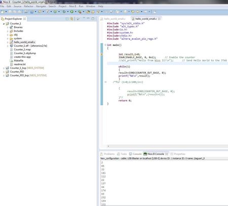

I am new to the Altera Quartus software tool.So Please anyone guide me to accomplish my task. Design Process involves: 1. Need to compile 8-bit, or 32-bit or 64-bit counter in Quartus 2. Interco...

>>Increase your verilog counter size to 32-bit (along with your PIO input) and see what you get.
I have followed your steps but same issue i am facing. I think AVALON FIFO memory will work it out. Can you help me in connection.
NIOS Screenshot for 32-BIT (attachment)
