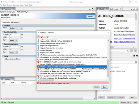

Greetings,
After upgrading to Quartus Lite 20.1, I cannot upgrade any of my older CORDIC functions to the newer version. Moreover, this does not seem to be an IP component upgrade issue, as and I c...

Yes, the same problem is able to replicate here, and this is the same issue as per the knowledge database below. You are unable to upgrade the function to v20.1std, and the problem will be fixed in the future software version release.
Regards -SK
Regards -SK
