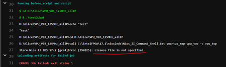

compiling quartus project using Git runner
Hi, I encountered a problem when I use git runner to build the quartus project. The project files are at the local side. I got the error like this: However, if I use the Nios II EDS command ...
  • Alice_YS_Chen's avatar
    Alice_YS_Chen
    6 years ago
    I just restart my computer system after adding an environment variable named "LM_LICENSE_FILE" and setting it's value "d:\file\license.dat" and it works!
    so, it must re-power on system.
