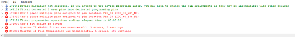

Hello, I am having trouble using EPCS16. Generating on NIOS II works well
but I get this error when I try to do a full compile in Quartus
"Error (176310): Can't place multiple pins assigned to pin location Pin_E3 (IOC_X0_Y34_N0) Info (176311): Pin ASDO is assigned to pin location Pin_E3 (IOC_X0_Y34_N0) Info (176311): Pin ASDO is assigned to pin location Pin_E3 (IOC_X0_Y34_N0)."

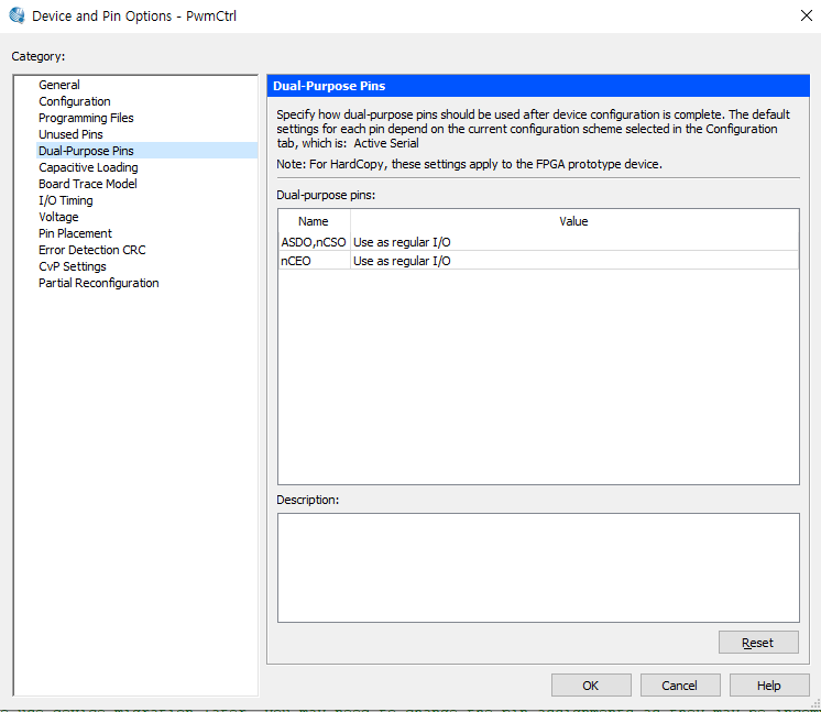

I heard that this problem can be solved by setting Device-dual purpose pin-User as regular I/O, but even after changing the setting, I still get the same problem. I am attaching my error message and Verilog HDL file for reference.

    Do you only make changes to ASDO pin (use as regular IO), or do you also make changes to nCEO pin? Can you only change the ASDO pin in as regular IO?
    Aiman
    • Dolemy's avatar
      Dolemy
      Thank you for your response.
      I only made changes to the nCEO option in the "dual-purpose pins" setting.
      There were no changes made to ASDO and nCSO.
      Additionally, for the ASDO pin that you asked about, it can be changed to either a regular I/O or a programming pin.
      If you have any information you would like to know, please let me know.
      I will respond immediately upon seeing it.

      Thank you. I only mentioned ASDO in my previous message, but in fact, nCSO also has the same issue. In the first image, two errors are reported. I will provide information on both of these errors:
      Error (176310): Can't place multiple pins assigned to pin location Pin_E3 (IOC_X0_Y34_N0) Info (176311): Pin ASDO is assigned to pin location Pin_E3 (IOC_X0_Y34_N0) Info (176311): Pin ~ASDO~ is assigned to pin location Pin_E3 (IOC_X0_Y34_N0)
      Error (176310): Can't place multiple pins assigned to pin location Pin_D3 (IOC_X0_Y34_N1) Info (176311): Pin nCSO is assigned to pin location Pin_D3 (IOC_X0_Y34_N1) Info (176311): Pin ~nCSO~ is assigned to pin location Pin_D3 (IOC_X0_Y34_N1)

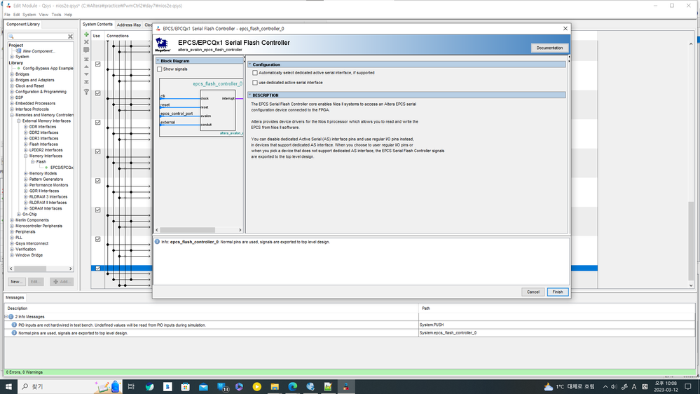

      Could not checking the "Automatically select dedicated active serial interface, if supported" option in the configuration when adding the EPCS controller to Qsys be the cause of the issue?

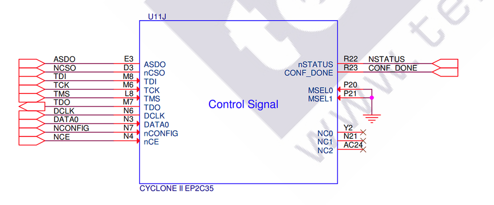

      This image is the schematic for the EPCS on the DE2-35 board.
