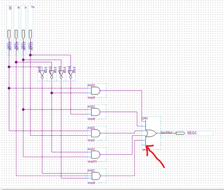

3 years agocompilation error due to blank input
Hello! does anyone know what I should do about the blank input for this or6 gate so the program can compile successfully?
- 3 years ago
Connect it to a logic 0 or one of the other AND gate outputs.
Will not change the logic function and it eliminates the unconnected floater.
