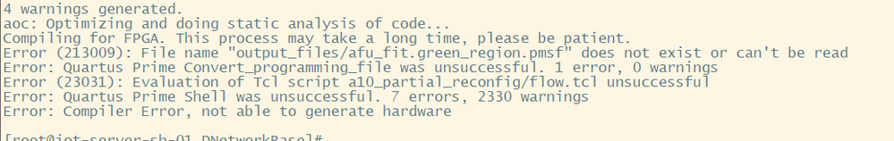

Our company try to use the Intel PAC with Arria 10 GX FPGA to accelerate our algorithm. We have been install the Intel Acceleration Stack 1.2 version for development. But we meet a quartus license problem, the quartus_sh_compile.log log file shows that the license has been expired. I found a related discussion on community: https://community.intel.com/t5/Application-Acceleration-With/Error-213009-File-name-quot-output-files-afu-fit-green-region/td-p/1193502 . And I noticed that a license patch should be uploaded if I want to keep our development. But the resource download link seems to requrie an CNDA to access.

Thanks for your reply. The CNDA is a Corporate Non-Disclosure Agreement which established for a approval access to some development resource. The reason I need to request a CNDA number is that, the Quartus license which bundled in Intel Acceleraton Stack are expired, and I need to download the Quartus license upload patch from Resource and Design Center. I need to sign CNDA to access that resource page.
My problem description:
Intel Acceleration Card type: Intel PAC with Arria 10 GX
Intel Acceleration Stack version: 1.2
I tried to compile an OpenCL kernel for my algorithm. When I use aoc command to generate aocx file, some errors exist as shown in the figure below.
And some warning shows in the quartus_sh_compile log as below:
Warning (292015): License for core 6AF7_0119, version 0000.00 is expired.
Warning (292015): License for core 6AF7_00FB, version 0000.00 is expired.
Warning (292015): License for core 6AF7_011B, version 0000.00 is expired.
Do you have any suggestion for my problem?
