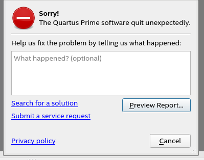

Chip planner crash: acvqm_dev_interface error
When I open chip planner, Quartus Prime Pro crashes. The error report that was generated is attached.

    Thank you for your response. We did give Quartus Prime Pro 22.2 a try but it still crashes when we open Chip Planner and I should let you know this is specific to one project of ours only. I would like to share the .qar file, can you please share with me channel through which we can do so? also can you let us know which options you require for the .qar file, Is file set option “Service request” suitable?
