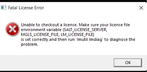

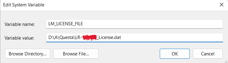

Hi, I followed the instructions to set up the questa license by setting LM_LICENSE as in the screenshot and this error didn't disappear and I can't open Questa.
This is on Windows 11.

I experienced this problem:
In case you have already a "salt_license_server" variable in your environment variables, the Questa license entry must be added there, otherwise it's ignored.
Frank- Mohammad_Wael
No, I don't have "salt_license_server" variable in my environment
Should I add it?
And how if I should?
- FvM
If you don't have a salt_license_server entry, lm_license_file should work. - AR_A_Intel
