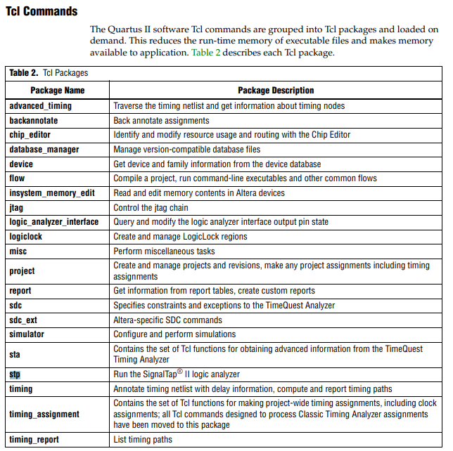

When I use the command as follows in the quartus_sh, tool said that "can't find package ::quartus::stp". Do you know what's wrong here? But the document shows that stp is the one of package. Thank you.
Command:
package require ::quartus::stp
Package: https://www.intel.com/content/dam/www/programmable/us/en/pdfs/literature/manual/tclscriptrefmnl.pdf

    If you look at Table 3 of the documentation you shared, the package is only loaded on quartus_stp executable. So you'll have to use quartus_stp instead of quartus_sh.

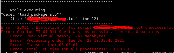

      Hi NurinaW. I get it. Thank you very much. And I have one more question. Does there have any methods to load the stp package in quartus_sh because I want to use "open_session" command which is the part of quartus_stp? I had tried the command as follows picture, but it can't work.
      Picture:
      This command causes an error.

    Again you'll have to use quartus_stp executable instead of quartus_sh to do that.
