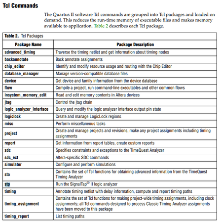

5 years agocan't find package ::quartus::stp
When I use the command as follows in the quartus_sh, tool said that "can't find package ::quartus::stp". Do you know what's wrong here? But the document shows that stp is the one of package. Thank yo...
- 5 years ago
Again you'll have to use quartus_stp executable instead of quartus_sh to do that.
Nurina
Nurina
5 years agoHi,
If you look at Table 3 of the documentation you shared, the package is only loaded on quartus_stp executable. So you'll have to use quartus_stp instead of quartus_sh.
