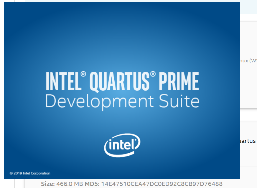

I am having trouble installing Quartus Prime Lite 20.1
I have downloaded the Quartus prime (includes Nios II EDS), the ModelSim, and max 10 FPGA device support. However, when I run the quartuslitesetup, it shows me the opening screen before closing.
I tried downloading the combined files and running setup.bat however the same thing happens.
Then I decided to follow some youtube videos online, where some videos run the other setups first (like the help), however, the same opening screens pop up before closing.
I tried deleting and reinstalling all these files again and even decided to go to a different version (20.1.1) of Quartus Prime Lite for the same thing to happen still.
What do I do? Any help would be appreciated.
