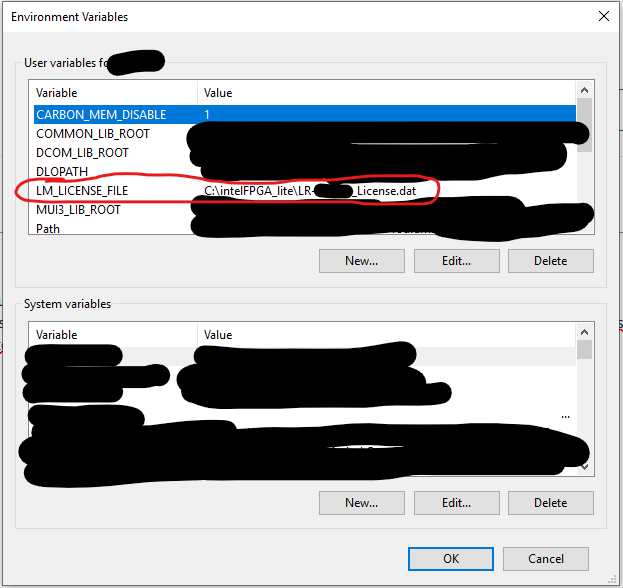

Thank you, after some hours I was able to get the .dat file. Now where should I locate it? I do not have a license folder in Questa.
- 07dshaffer4 years ago
You don't need a license folder. Just store the license file somewhere you won't accidentally delete it later, and setup an environment variable if you are using Windows. See community.intel.com/t5/Intel-FPGA-Software-Installation/Has-anyone-succeeded-running-Questa-Starter-with-license-file/m-p/1343087#M3451
