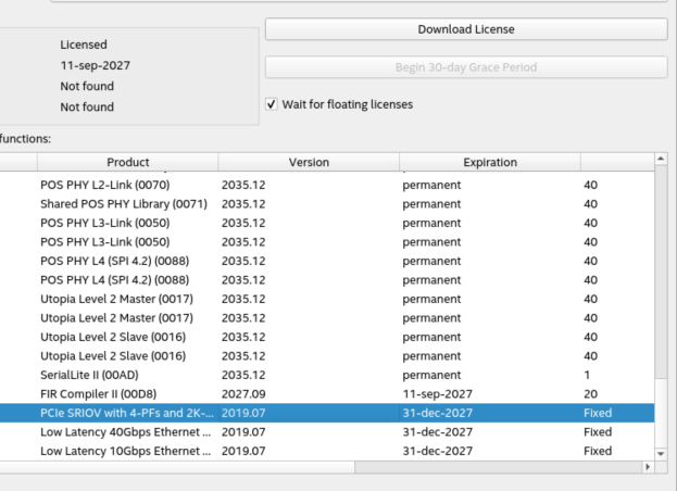

I use a LM server in which we have several floating licenses. When I check available licenses patched with the last update, I see them correctly installed as described in
here's the output of my Quartus 19.2 licensing window
But the error complains about a licensing error specfic to Stratix 10 device.
What should I do?
