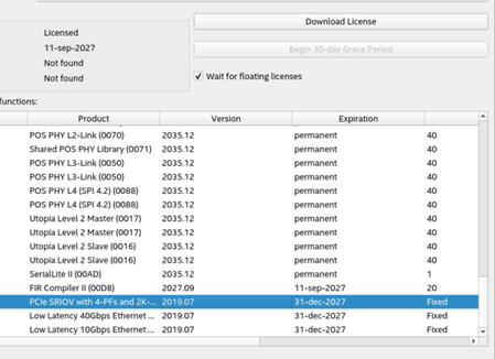

Cannot compile for D5005 due to failing license

Welcome to INTEL forum. My guess is, this error occurs because the FlexLM library has been upgraded. Could you help to upgrade the license daemon (alterad) software to the newer version v11.16.2.1.and try it.
The new daemon software can be downloaded from the website.
For more refer to KDB https://www.intel.com/content/altera-www/global/en_us/index/support/support-resources/knowledge-base/tools/2019/error-119013---current-license-file-does-not-support-the--device.html
Hope this help.

You are right!
With the updated deamon my compilation is working!
Thank you so much!
