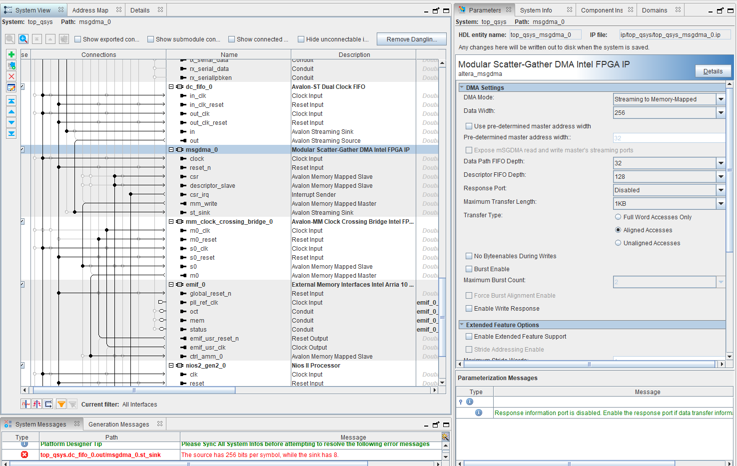

I am building a project aimed at saving data from the JESD204 interface to DDR4 memory using the msgDMA module.
JESD204 is configured as - LMF - 882. So use 8 links. There are 256 bits of data in the output.
MSGDMA is configured as streaming - Memory mapped.
I wanted to make the system as follows. In parentheses I find the name of the configuration:
JESD204 (jesd.png) --> DCFIFO (dcfifo_1.png) --> MSGDMA (msgdma_1.png) --> DDR4
DCFIFO - symbol per beat: 32, Bits per symbol: 8.
msgdma - Data width: 256
Unfortunately, the error on the DCFIFO side:
"The source has 256 bits per symbol, while the sink has 8."
By changing the configuration:
DCFIFO - symbol per beat: 1, Bits per symbol: 256
Error on MSGDMA side:
I found in the UG-01085 documentation dated 2020.09.21 (doc_1.png) that it should support this type of format.
Is this an error of the msgda module? am I just doing something wrong?
I use the Arria 10 GX Development Kit with PN 10APCIe0003927.
Quartus version 19.4.0. I also checked this module in version 20.2.
Operating System: Windows 10pro
The attachment also includes a simple program simulating the above case.
