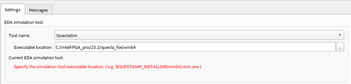

During the installation, I didn't think I needed the 'full' or 'paid' version? I just installed the FSE version. When I went back to the installer, I had the long shot idea of installing both, so there are now questa_fe and questa_fse directories as shown.
Then simply select the questa_fse directory as shown below:
and.... success...
I wish you luck!!

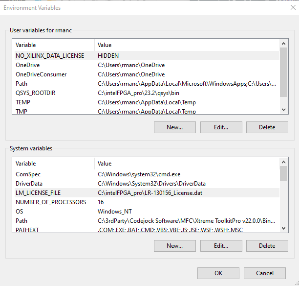

Prime Software SW-ONE-QUARTUS Primary Machine : AlienwareStep 2: Next, you need to create a system variable called LM_LICENSE_FILE that points to wherever you put that license file.

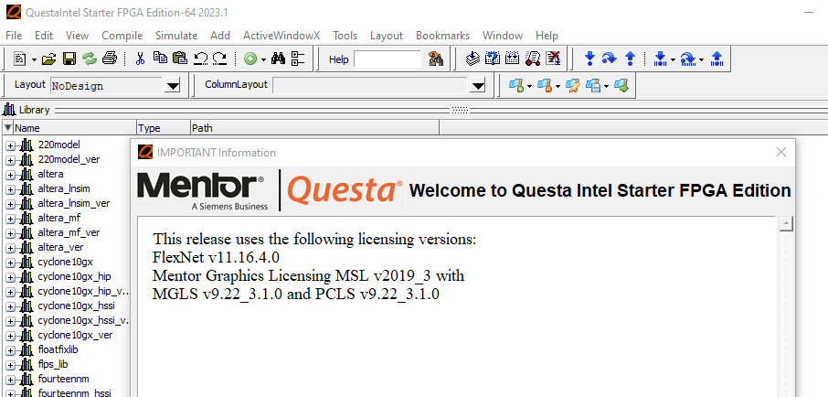

Step 3: After this, you should be able to run Questa from the Start Menu (this IS vsim.exe).
If you can't get past here, stop and try and make this work first.

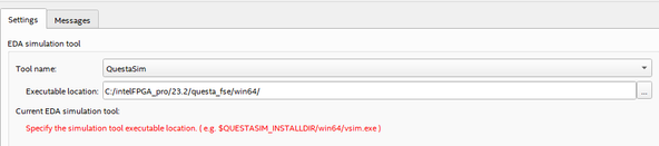

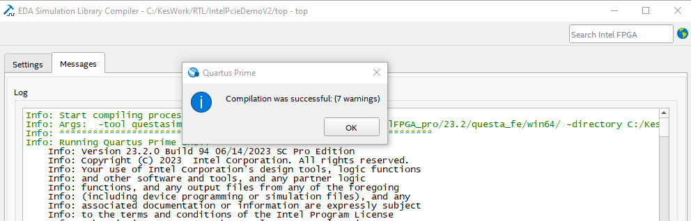

Step 5: Have a priest bless your PC. Sacrifice a virgin if you have one handy. What I found to work here makes only the slightest bit of sense. But I have repeated it over and over again. I select the fse directory. (for you replace win64 with win32.....)
Hit select folder.
Delete the 's'. And Start Compilation.

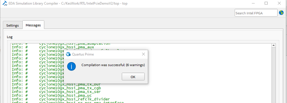

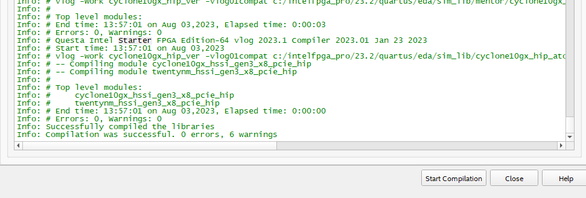

First time - 6 warnings. Note if you do Start Compilation again, it will fail. Repeat process from select folder (deleting the 's' like a crazy person).
Second time - 7 warnings. The warning is due to overwriting a protected file that I generated from the first run. There is no third time. No matter what I do, I can't make it work again until I delete the contents of the output directory. Can run twice and then have to clean.

Here is where I delve into complete speculation. As a software designer, I know that the contents of that textbox should have updated a variable after we selected the file. That variable is what should be used when we press Start Compilation. It appears as if it does not. By editing the textbox, that appears to have updated the variable and THEN we can run Start Compilation. I tested using select folder to FE directory and added a '/' at the end and it worked ... though it wasn't as repeatable as what I documented above. I also have made it compile using selecting FSE folder and adding the '/'. (Whole different VSIM!!!!)
