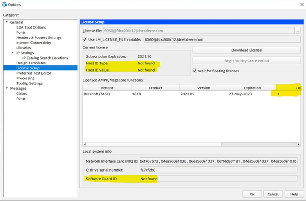

      Hello Team,
      The license file is set up as per the instructions.
      The debug file showing the license check in and Check out, however user is still getting the “Time Limited” sof file output.
      Attached herewith the logs and error snap. Can you please check and help. Please let me know if you can be available for troubleshooting meeting, I will schedule as per your availability.

    Hello Team,
    Can you please share the email ID or location where I can share the information privately, I am getting emails from Intel Community <[email protected]> to which I think I can not respond to.
    For privacy, reply/attach file in private message. - can you help with this, how can I do this.
    1) assembler report .asm.rpt file - will share once I know how to attached it privately or has any email ID to share with.
    2) Error message screen shot - Attached herewith
    3) Screenshot of Quartus II>>tools>>license setup - Attached herewith
    4) Machine OS information - Client - Windows 10 , Server - Microsoft Windows Server 2012 R2 Standard
    5) Quartus version used - 2016.10
    6) Output of “lmutil lmstat –a –c <port>@<address>” server and client -will share once I know how to attached it privately or has any email ID to share with.
    7) License.dat file (Questa) - we are using the license file from Bechkoff Ethercat , will share once I know how to attached it privately or has any email ID to share with.
