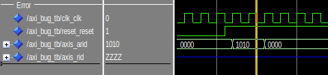

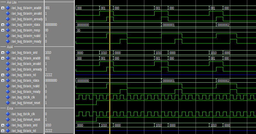

AXI Translator ignores transaction IDs
The AXI to AXI-Lite Translator provided by the Quartus Version 21.1 Platform Designer fails to generate the transaction id signals rid and bid.
This issue and a potential fix was already described two years ago in this question link
thanks in advance,
Alex

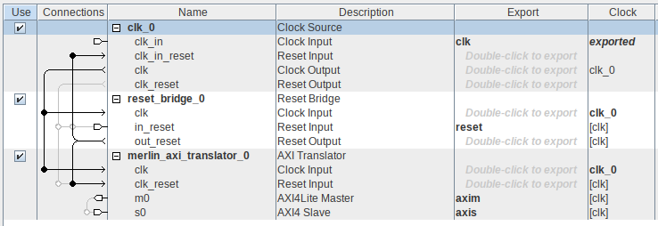

Example:
Instantiation of axi_translatorrid signal not set
