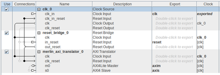

The AXI to AXI-Lite Translator provided by the Quartus Version 21.1 Platform Designer fails to generate the transaction id signals rid and bid.
This issue and a potential fix was already described ...
