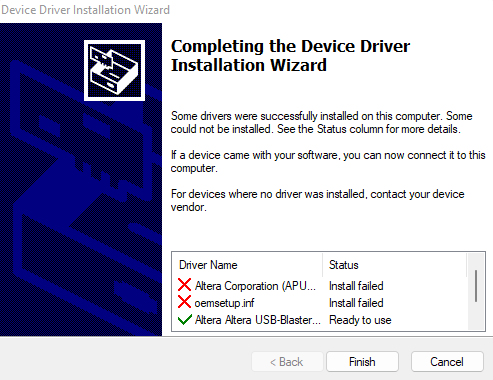

We are looking to deploy Quartus Prime Standard to a few labs in our environment. We are running into issues with a driver that's included in the Quartus Prime packages provided. We've seen this issue in versions 20.1.1 and 21.1.1 (Standard and Lite).
We are attempting to use the following hardware via USB A to B cable:
DE10-Lite (MAX 10 10M50DAF484C7G)
The drivers that seem to be required are the following:
Altera Corporation APU USB (included version does not work. Version 1.20.0.6)
  • It seems this driver's signature is not valid and cannot be installed.
Altera USB-Blaster Device (included version works. Version 2.12.28)
Altera WinUSB JTAG cables (included version works)
We are unable to install the APU USB Driver without disabling Driver Signature Enforcement in Windows, which is not an option for us in our lab environments.

    • reschrei's avatar
      reschrei
      Affects both my Windows 10 and 11 systems the same (This is from Windows 11 Enterprise 21H2)
      If I don't install this driver, Quartus will hang when launching a new empty project with the device selected.
      I've attached the DPinst.exe log files. You can see the apu_usb.inf driver fails to install with (0xE000022F). Seems to be an error due to an invalid signature on the driver.

    I am glad that the problem is solved on your side. FYI, APU USB Driver is an old driver and won't be compatible with current windows any longer. Only the USB Blaster Driver instead is needed for the latest windows (10 and above).
