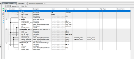

ADC toolkit - Max10 10M50DAF484C7G
Hi So I want to see if I could configure everything ok in my ADC. I used platform designer for the configuration (I have a de10-lite eval board) and create my top level entity ...

    May I know which Quartus version are you using? Could you try to upgrade to the latest Quartus version 22.1 std and check if the issue reoccur.
    Please re-generate in Qsys and re-compile the design, so the .sof and the toolkit are in sync with each other.
