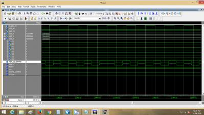

I am working for the first time with FPGA (cyclone v soc) and i am trying to get a output from VGA Port on the monitor. I have set the resolution for 1024x768 and PLL input frequency as 50MHz and output frequency as 65MHz as required for the resolution.But as soon as i program the board the monitor is going to sleep mode. I am attaching the code which i used for this. Can you please tell me what may be the problem. When I checked in RTL Simulation PLL is not generating any clock output. Thank you in advance. Code: ----Main code LIBRARY IEEE; USE IEEE.STD_LOGIC_1164.ALL; USE IEEE.NUMERIC_STD.ALL; ENTITY VGA IS PORT( CLOCK_24: IN STD_LOGIC; SYS_rst : IN STD_LOGIC; VGA_HS, VGA_VS: OUT STD_LOGIC; VGA_R, VGA_G, VGA_B: OUT STD_LOGIC_VECTOR(7 DOWNTO 0); VGA_CLK_65MHZ : OUT STD_LOGIC ); END VGA; ARCHITECTURE MAIN OF VGA IS SIGNAL VGACLK, RESET, lock : STD_LOGIC :='0'; signal SIGNAL_135MHZ : STD_LOGIC:= '0'; COMPONENT SYNC IS PORT ( CLK : IN STD_LOGIC; HSYNC, VSYNC : out std_logic; R, G, B : OUT STD_LOGIC_VECTOR(7 DOWNTO 0) ); END COMPONENT; component unsaved is -- PLL Component port ( pll_0_locked_export : out std_logic; -- pll_0_locked.export pll_0_outclk0_clk : out std_logic; -- clk pll_0_refclk_clk : in std_logic := '0'; -- clk pll_0_reset_reset : in std_logic := '0' -- reset ); end component unsaved; BEGIN inst_pll : UNSAVED port map ( pll_0_refclk_clk => clock_24, pll_0_reset_reset => SYS_rst, pll_0_outclk0_clk => VGACLK, ---CLOCK 65 MHZ --outclk_1 => SIGNAL_135MHZ, --- CLOCK 135 MHZ pll_0_locked_export => lock ); INST_SYNC : SYNC PORT MAP ( CLK => VGACLK, HSYNC => VGA_HS, VSYNC => VGA_VS, R => VGA_R, G => VGA_G, B => VGA_B ); VGA_CLK_65MHZ <= VGACLK; END MAIN; ---Sub Program LIBRARY IEEE; USE IEEE.STD_LOGIC_1164.ALL; USE IEEE.NUMERIC_STD.ALL; ENTITY SYNC IS PORT( CLK : IN STD_LOGIC; HSYNC, VSYNC : out std_logic; R, G, B : OUT STD_LOGIC_VECTOR(7 DOWNTO 0) ); END SYNC; ARCHITECTURE MAIN OF SYNC IS SIGNAL HPOS: INTEGER RANGE 0 TO 1344:=0; SIGNAL VPOS: INTEGER RANGE 0 TO 806:=0; BEGIN PROCESS(CLK,HPOS,VPOS) BEGIN IF(CLK' EVENT AND CLK='1') THEN IF (HPOS = 832 OR VPOS = 422) THEN R <= (OTHERS => '1'); G <= (OTHERS => '1'); B <= (OTHERS => '1'); ELSE R <= (OTHERS => '0'); G <= (OTHERS => '0'); B <= (OTHERS => '0'); END IF; IF(HPOS<1344) THEN HPOS <= HPOS+1; ELSE HPOS <=0; END IF; IF (VPOS<806)THEN VPOS <= VPOS+1; ELSE VPOS <=0; END IF; END IF; IF (HPOS > 24 AND HPOS < 160)THEN HSYNC <= '0'; ELSE HSYNC <= '1'; END IF; IF (VPOS > 3 AND VPOS < 9) THEN VSYNC <= '0'; ELSE VSYNC <= '1'; END IF; IF ((HPOS> 0 AND HPOS< 320) OR (VPOS>0 AND VPOS< 38)) THEN R <= (OTHERS => '0'); G <= (OTHERS => '0'); B <= (OTHERS => '0'); END IF; END PROCESS; END MAIN;
